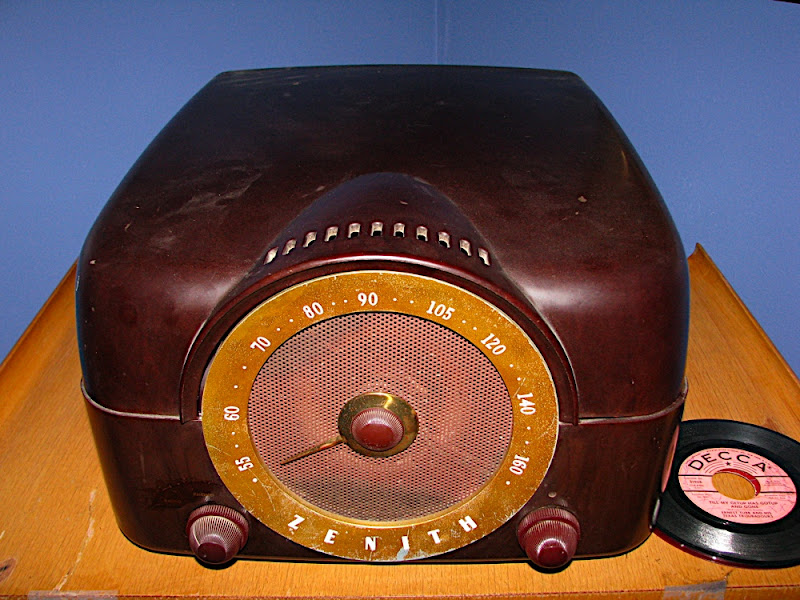

This is my first time to post since I sold two antique radios here last year. This lady at work asked me if I wanted her parents old radio and of course I said YES!!!!! It isn't what I expected at all. Giant bakelite WOW.
The radio works on a couple am channels. The TT spins but I would say plays but more like skips growls rumbles and bops along skipping like a little girl. This is way more than I expected it to do. I did bring it up on a variac.
I am ok with an iron. I really would like to be able to play decent mono 78's on this puppy or is the cobramatic to brutal on the records. Are there any restoration guides for these or should I just keep it as a display.
Any advice much appreciated.

Actually the Cobra-matics are pretty gentle on records compared to others of that era. You have to make sure you have the proper needle/cartridge for the type records you'll be playing on it. The needle and cartridge is an all in one plug in type assembly. When you replace the needle, you are replacing the cartridge too. They come in three color combinations depending on what records you'll be playing on it.
A red cartridge is for 78's only and has a 3 mil. tip. This would be the one you would need to play your electronically recorded 78 rpm records on.
The red/green cartridge is supposed to be a universal replacement that supposed to handle 78's, 45's and 33rpm mono records. It is a 2 mil. tip. I dont recommend using this one as its not good for any of them as far as record wear, skipping and they sound horrible because the stylus doesnt truly fit the grooves properly reguardless of speed. The only speed you can really use this one on is 78's only but it will produce alot of surface noise.
The green cartridge is for 33 and 45rpm mono records only and has a 1 mil. tip.
There are some aftermarket replacements with a .7 mil tip so you can safely play stereo records on this changer. They can be found on most jukebox parts supplier sites. Wurlitzer used cobra cartridges in several of their earlier machines.
I recommend that you find a red cartridge to play your 78's and find a green cartridge if you want to occasionally play some mono 45's or 33rpm records. Dont waste your money on the red/green cartridges. It only takes seconds to change out the cartridge and you'll have a container to place the spare one in when your not using it.
Due to how these are constructed, you dont have to worry about getting a "dud" cartridge as theres no ceramic or crystal element inside these. They work more like an oscillator instead of like the traditional cartridges we're used to. The only bad ones i've run across were ones that the tip was worn out but still had normal output.
I have two of these and one that has the different front and they all sound great when gone through. The 8 inch speaker makes all the difference and produces a nice tone usually found in larger sets. You may have to have the roller (speed control) tire replaced, the idler rebuilt and replace the motor mounts to quiet the changer noise. When these arent used on a regular basis, they will develop flat spots, causing thumps and other noises. Once that is done, the changer is almost silent in operation. The center spindle design is great as even though the changer cycles fast on 78 speed, the design makes sure the records drop smoothly instead of crashing like other changers of this era. I've never had my cobra's break a record during the change cycle. Nice find and keep us posted on your progress.

The rumble you described sounds like bad rubber on the idler wheel. Not to worry. There is a great guy in Mississippi who rebuilds them. I had him rebuild mine about a month ago. The little cobra head doesn't skip a beat! Have you checked out the Phonograph index here yet?

I was just showing it to a friend and the top dropped down pretty hard destroying an old 78 caught between lid. The recorded didn't stand a chance. After the lid dropped sound doesn't come out of the phono stage any more but the radio is great. I'm going to buy a new tube compliment and see what caps and resistors I need to buy. It can't have that many parts lol.....
