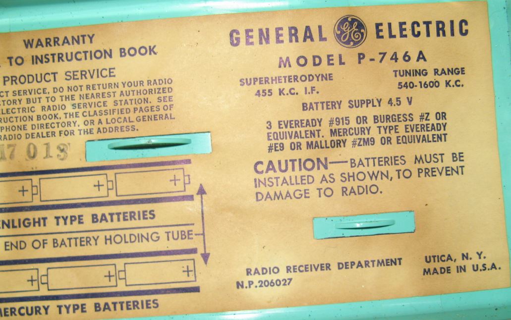

My caps arrived and are now installed. Unfortunately the GE 745 is still dead. Those who are familiar with this set know that three AA batteries slide into a tube with no markings on either end. Naturally I managed to reverse polarity. Have I damaged anything?
"CIVILITY IS RECIPROCAL"

I doubt that you harmed anything with 4-1/2 volts.
The second biggest cause of a dead Transistor set is the contacts in the earphone jack not touching each other. Use a screwdriver and push the inner blade against the outer one just below it, to see if you can get audio.

It isn't voltage that causes issue, it's current. A good set of AA batteries can easily produce a ½ amp, exceeding limit of early transistors by 5-10x their rating.
If there isn't a small pop/thump in speaker when rocking the on/off switch back and forth, explore speaker, wiring, jack etc.. If that seems ok check to see if osc is operating.. With another radio tuned between 1200-1600, your radio should produce a signal tuned around 750 to 1150Kc. The osc was dead on my P-746A, after recapping which got audio working, I wound up replacing osc transistor.
GE gives a warning regarding polarity reversal.

I installed batteries when I had the battery holder out of the case so I didn't have the mounted reference to guide me. Further more the + end of the case has the spring that in my experience always denotes the negative. What's worse is that I installed them correctly initially and did experience a faint click in the speaker when toggling the on-off switch. After the recap is when I reversed polarity. No click now I'm afraid. Started checking voltages at the output transistor. The emitter is OK at 4.5 but the base is supposed to have 4.4 and it is a fraction of 1 volt.

Trace what components are feeding that base. The failure could be upstream from the Transistor.
 Post subject: Re: Electrolytic source for transistor radios
PostPosted: Jun Wed 20, 2018 3:11 am
Posts: 13846
If any of the caps in audio output are reversed that will pull down voltage.
Easiest test is check the B-C forward & reverse resistance of output transistor(use meter diode scale). If you measure near zero ohms in both directions, likely the xistor is shorted. To be sure, either B or C should be disconnected. I gently use wick for desolder to let appropriate lead "float".
BTW for std AA batt the spring is negative... For whatever infinite wisdom, mercury batteries had connections reversed..
