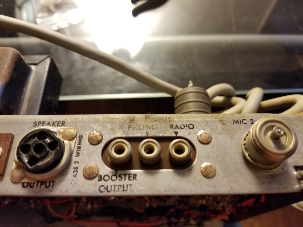

Here are the connectors. I'll probably look like I know nothing at all even more but I cant find them. I actually dont know the speaker or mic connectors.

Center ones are just RCAs, one on the right is an old timey coaxial mic connector. Im sure someone knows the real name. The speaker conector is also an old time thing that is long forgotten. I guess that wasnt much help. :lol: You can defo get them.

 Post subject: Re: Fanon Masco FMA-20
PostPosted: Aug Sat 18, 2018 7:39 pm
Posts: 5288
Location: Black Hills, SD 57745
A peek at the rear of the speaker would show which pins were used. One should be a ground/common. If more than two, might be for different speaker impedances or perhaps even a 70-volt output, which would require a transformer on the speaker itself. That's used for long wiring runs or multiple speakers in different locations. Otherwise, you should see the 4/8/or 16 ohm output, which would come from an output transformer on the amp's chassis. The manual should help sort that out.
Lacking a proper connector, you can insert a rod or screw that fits into the sockets and solder or clip your speaker wires to that. Slip a tube or heat shrink over them or tape 'em to keep them from touching one another. You could also skip the pin idea and just solder wires directly to the terminals on the rear. Not as elegant as the correct plug, but it'll work till you locate one.
The mic is an Amphenol connector. I have several from my dad's old parts stash. Also used on some vintage test probes. There's probably adapters to convert it to a more modern mic connector or your own available connector could be soldered on to the rear, like with the speaker, just using a short shielded cable for the hookup.

Good info, not home at the moment but I remember it being 3 wires. I think one went to a screw that is used to select the impedance of the speaker, one for postive voltage, and one for ground. I think
But I'm not sure where all three wires would go on a speaker. The impedance selection screw selects a different wire from the transformer. Maybe the other wire that I said is postive, isn't what I think it is. Haven't traced it that far yet. Not sure really, haven't really seen too many 3 wire speakers. Unless it's related to XLR?

Update: I was very very wrong :lol:
Okay so there are 2 speaker connections. One labeled 70 volts and one not.
On the non 70 volt connection, it has a ground wire and has the impedance selection wire that picks different wires of the transformer.
On the 70 volt connection, it has ground, shares the same impedance selector, and has a 3rd wire from the transformer.
So if I figure out this popping/short I could test it.
