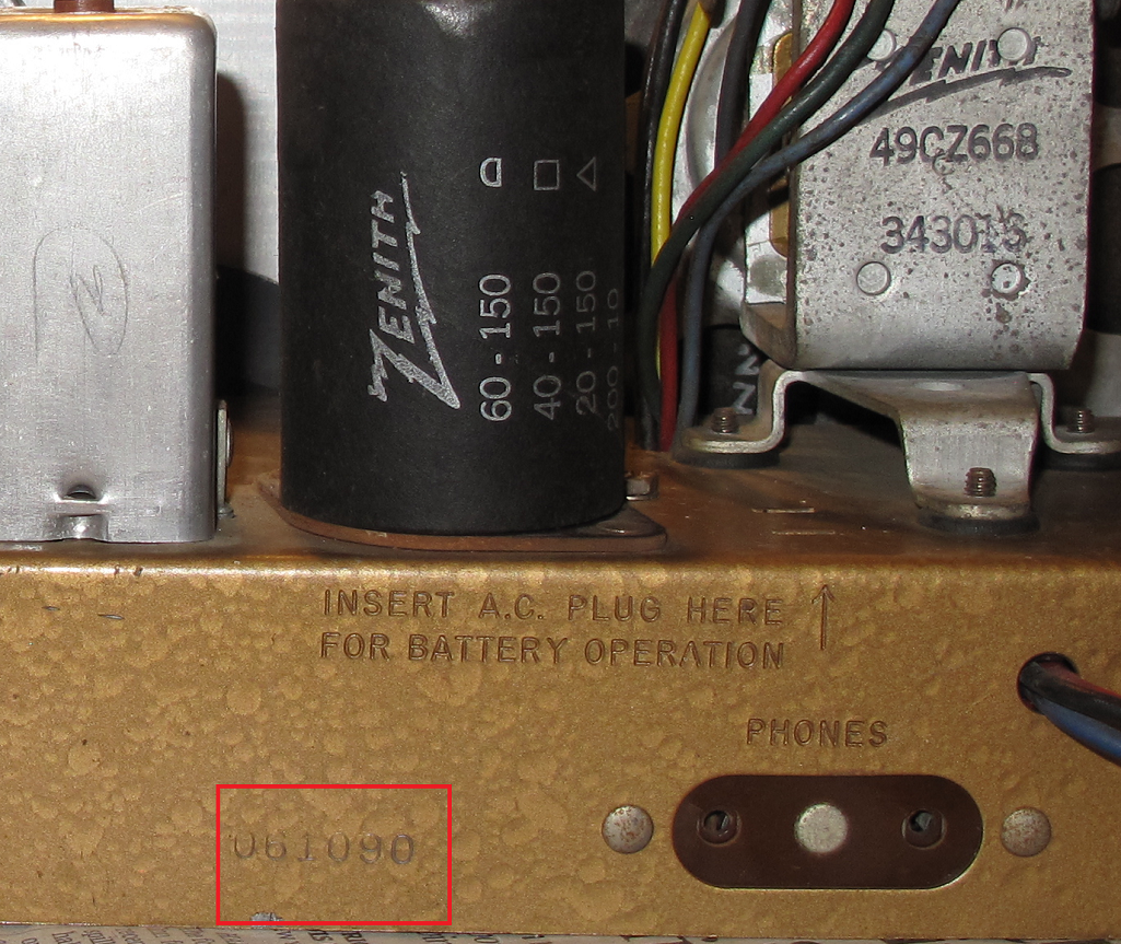

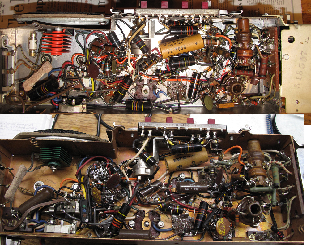

I acquired another $20 ZTO G500 this weekend. This one is the lower unit in the photo, with the green selenium rectifier, the number stamped into the metal on the chassis back is 186502.
The top unit with the orange rec is another G500 I bought this spring and has 061090 stamped in the metal on the chassis back.
Were there 125,412 units built between these two? (That seems like quite a lot!)
After studying the new one for one evening, seems the layout in the top one is messy compared to the lower one and the components are different, the black resistors in the bottom unit and brown capacitors for example. Wiring layout seems to be very close. Colors on the wire fabric and general condition seems much better on the lower unit.
Was the top one was built by someone having a bad day? The soldering style is very different between the two as well, the bottom one seems to have used much less solder and component placement is neater, more orthogonal, you could actually get a probe on the pins of the 3V4 without pushing too much. Thinking of the difference between FOXCON made electronics today and the Zenith manufacturing process then is, well, daunting.
A search of the forum didn't give up a ZTO G500 serial number series, so I'm not sure if the number I'm referencing is the correct one, see red box in bottom picture.
Both radios were built on a assembly line, numerous persons had a hand in assembly. With less experience on the model,
no doubt workers were not as neat in early production units(look about same to me).
Code dates on components will give a approximation of period radios were built. I believe for TO that info has been well researched.

The biggest difference I see is the 1 or 2 watt 820K resistors on the socket next to the rectifier, 3V4 ?, were replaced with smaller 1M resistors. Yes, that makes more room at the socket.
Anyway, it is interesting to compare.

Did a little sleuthing, this link states around 90,000 G500 were built.
I thought there was unlimitless info on these but I didn't find much either.
http://www.radio-antiks.com/IndexRadio- ... h_G500.htm
I will take a stab that 061090 is the 61,090 built, year 1950 &
186502 was 86,502 built, year 1951.
That'd place builds 25,412 apart
If the one with higher ser number was built in 1951, I'd bet my guesstimation is correct.

In the hopes of contributing to the investigation here, I pulled down by G500 and recorded the serial number and a number of production codes.
Serial #: J-198363
Speaker Date Code: 343939 (Sept.-Oct. 1949)
Tuning Capacitor Date Code: 273-937-108 (Sept. 1949)
Electrolytic Can Date Code: 102948 (Nov.-Dec. 1949)
I also took a look at my copy of Bryant & Cones The Zenith Trans-Oceanic: The Royalty of Radios. They list that total production for the G500 was 89,681 units with 16,244 being produced in 1949, 51,634 being produced in 1950 and 21,803 being produced in 1951. They also say that the G500 was last offered in print advertising in May of 1951.
With the data listed in this thread we can summarize the following:
Unit J-198363 would have had to have been made after Dec. 1949
Unit 061090 would have had to have been made after Jan. 1950
Unit 074983 would have had to have been made after June 1950
Unit 186502 would have had to have been made after Sep. 1950
It would not appear that the serial numbers follow a congruent pattern as the OP points out there are 125,412 proposed units between his examples and with less than 90,000 examples produced (and only 51,634 in 1950) there can not be examples bearing every serial number.
I hate to correct 35Z5, but with only 67,878 examples produced in total by the end of 1950, that eliminates the possibility of the first digit representing the year as Unit 074983 could not have been the 74,983 example produced in 1950. Unless of course there were non-continuous serial number blocks being used.
My example also throws a wrench into the mix, as it has a J-Prefix, as do a number of other examples I have seen, which have the serial number printed on a paper tag affixed to the chassis rather than being stamped on.
I too would be interested in hearing the findings of Mr. Blankinship and whether he has a solution to decoding the G500 serial numbers.

I looked at my G500's and the results are very inconclusive.
I haven't pulled any of the chassis recently and I don't recall if the radio assembly date was stamped on the chassis shelf as was done in many of the later ZTO's. The only consistently dated part readily accessed is the speaker assembly so I took the numbers from them.
1) S/N 188835 (no S/N sticker): Speaker stamp - 343043, installed Oct 1950 or later.
2) S/N 264489 (no S/N sticker): Speaker stamp - 343101, installed Jan 1951 or later. IF can stamped 198051, manufactured Dec 1950.
3) S/N J-376899 (no stamped S/N): Speaker stamp - 343015, installed Apr 1950 or later.
Difference between #1 & #2 serials is over 75,000 and #2 & #3 is over 112,000, the difference between #1 & #3 is over 187,000.
I'm guessing dating will be a very hazy guestimate on anyone's part.
Were the "J" the initial issues of the G500? The earliest dated speaker was in the J-376899 chassis and the later issued speakers were installed in the chassis' lacking a sticker and with a lower serial number sequence.
Does anyone have any input that may reveal a way to date the G500's?
For the future I intend to make notes on all my ZTO's that include any stamped dates and date codes to see if anything can be used to indicate production/assembly dates of the units.
