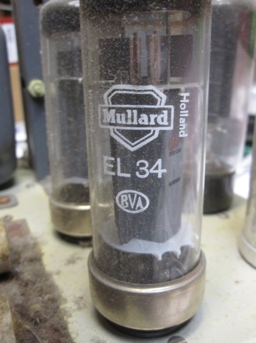

The sales brochure showed you could order it with a 4 ohm tap for an additional $5.25. The MK III used the same OT, but includes 4, 8, & 16 ohm taps, chrome chassis, choke, biaset, and used the 5ar4/gz34 rectifier for an increase of 10watts vs the MK II. I think it's easy to convert a MKII to a III if you don't care about the 4 ohm tap or chrome plated chassis. These things are easy enough to disassemble it wouldn't be too difficult to powder coat the chassis any color you like for a custom job. And it's small enough to fit in my toaster oven. Guess I need another one or sell the one I've got. I've had it for about 10 years and just opened it up for the first time yesterday :shock:. Besides a lot of dust it has a pair of early Mullard EL34's in it. I'm guessing they are original. On my Hickok 600 one tested 8500gm and the other 7250gm. I assume they were matched originally, but have aged differently due to a lack of provisions to adjust bias individually.
Matt
